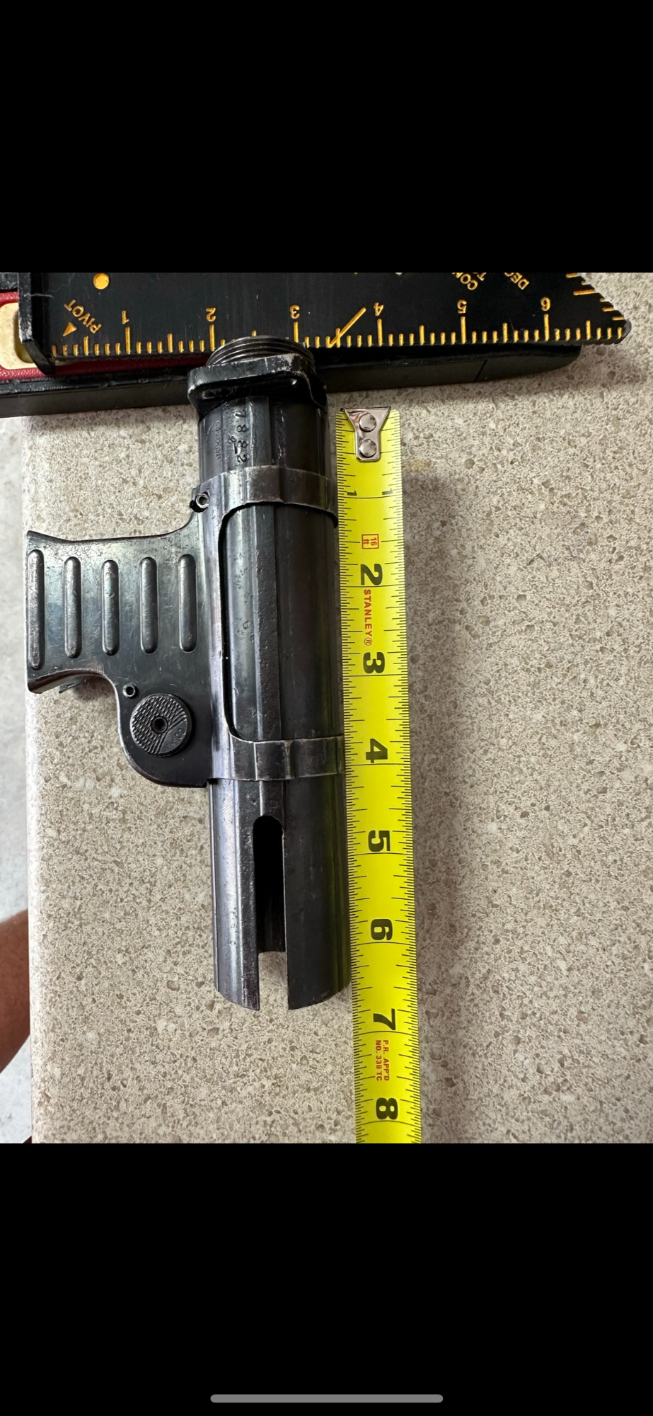

signal_4 Posted December 30, 2023 Report Share Posted December 30, 2023 I have a demilled receiver section that was one of the ones that must have escaped modification. Would like to get the hook style bolt to go with it to make a display but they are so damn expensive now. Link to comment Share on other sites More sharing options...

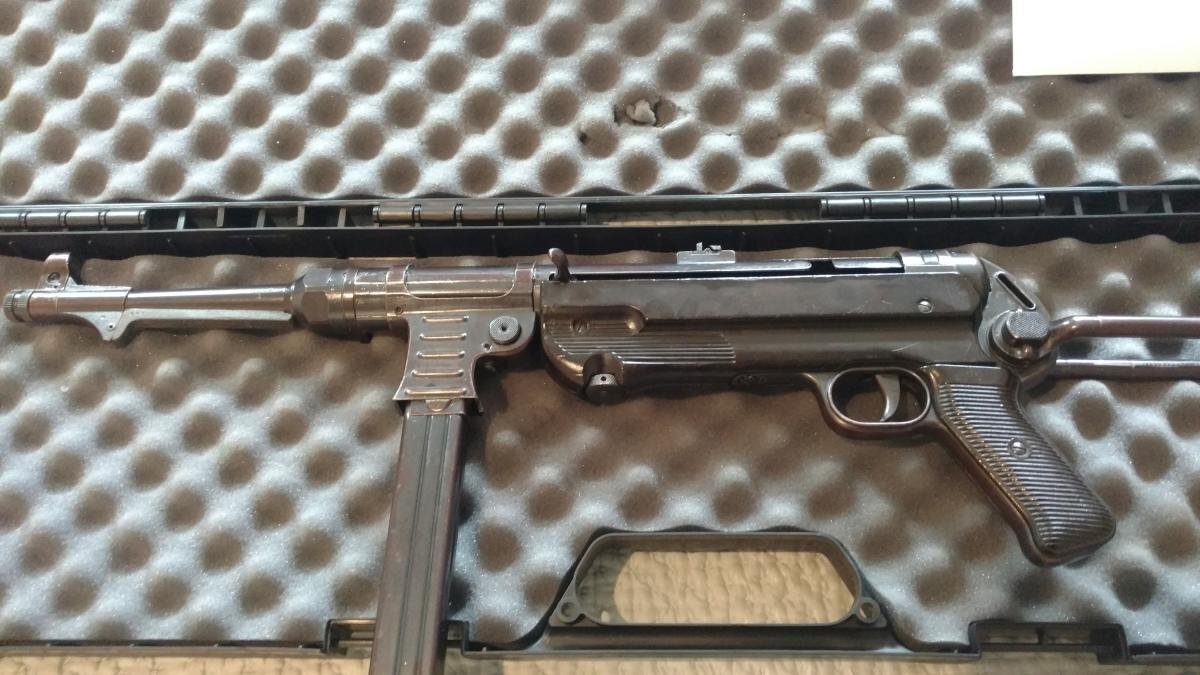

Robert Henley Posted January 1, 2024 Report Share Posted January 1, 2024 (edited) A repost of a picture of my MP40 BNZ41 which I bought from the son of the WWII vet that brought it home and registered it in the 1968 Amnesty. Note the hook style bolt and unmodified receiver. Also, a short video of firing it: https://youtu.be/xEh5zg_-ztU Robert Edited January 1, 2024 by Robert Henley Link to comment Share on other sites More sharing options...
signal_4 Posted January 2, 2024 Report Share Posted January 2, 2024 On 1/1/2024 at 10:31 AM, Robert Henley said: A repost of a picture of my MP40 BNZ41 which I bought from the son of the WWII vet that brought it home and registered it in the 1968 Amnesty. Note the hook style bolt and unmodified receiver. Also, a short video of firing it: https://youtu.be/xEh5zg_-ztU Robert Mannnnn Lucky you !!!! Oh your video is set to private. Link to comment Share on other sites More sharing options...
Robert Henley Posted January 3, 2024 Report Share Posted January 3, 2024 14 hours ago, signal_4 said: Mannnnn Lucky you !!!! Oh your video is set to private. Try it now. I thought if you had the link, you could view it. I think you can now. Robert Link to comment Share on other sites More sharing options...
TSMGguy Posted January 3, 2024 Report Share Posted January 3, 2024 "Video unavailable. This video is private" Oh, well. Link to comment Share on other sites More sharing options...
Robert Henley Posted January 3, 2024 Report Share Posted January 3, 2024 I think what happened is I didn't answer the question about "saved for kids" (which I didn't think was relevant) and it defaulted to the original private setting. I answered it this time, so should work. Obviously not that familiar with YouTube settings. Hopefully works now. Link to comment Share on other sites More sharing options...
signal_4 Posted January 3, 2024 Report Share Posted January 3, 2024 6 minutes ago, Robert Henley said: I think what happened is I didn't answer the question about "saved for kids" (which I didn't think was relevant) and it defaulted to the original private setting. I answered it this time, so should work. Obviously not that familiar with YouTube settings. Hopefully works now. Yes Sir ! It plays now !!! Great video ! Link to comment Share on other sites More sharing options...
TSMGguy Posted January 3, 2024 Report Share Posted January 3, 2024 (edited) Looking good, Robert! My own bnz 41 MP40 runs the same way. It seems to like 124 gr. NATO 9mm M882 the best and will run more slowly and occasionally short stroke with Winchester 115 gr. white box. Edited January 9, 2024 by TSMGguy Link to comment Share on other sites More sharing options...
