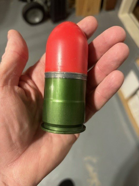

Rekraps Posted January 29, 2024 Author Report Share Posted January 29, 2024 But, they look so much better with the aluminum cases. Check it out! That's a good looking round! Link to comment Share on other sites More sharing options...
