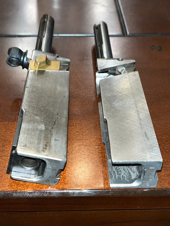

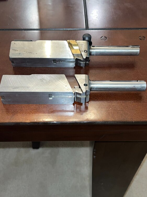

Lawman9328 Posted May 3, 2023 Report Share Posted May 3, 2023 As a newer member of the community and after reading, researching, and reviewing the forum, I'd like to be sure I have a correct understanding of something...... I have two "silver colored" bolts (photos included)....one in my Thompson, the other as a spare. Both are marked as Savage. I've seen all the different (and VERY non-standardized) terminology used to describe similar colored bolts (i.e. - "nickel bolt", "nickel alloy bolt", "white bolt", "un-blued bolt", etc ,etc.) Am I correct that in reality all bolts are made of the exact same composition of metals and the only difference was whether they were blued or not ? From what I seem to have read, all bolts have a little bit of nickel in them to help strengthen them ("nickel alloy") and that other terms like "nickel bolt" and "white bolt" are just terms that are really just used to describe the color. It also seems that in some discussions the belief is that the blued bolts have a slightly better resistance to corrosion. I'm just trying to get a basic understanding to help me when I see stuff for sale on various websites referring to the different colors or composition of parts (whether bolts or other internal parts) Also....I just noticed that my "spare" bolt has more shine, has sharper corners, and more visible "milling" marks. Is that just a result of less "wear and tear" since it's been used less ? Is it possible to tell whether my bolts were previously blued but had it removed at some point ? Thanks in advance. Gene (aka "Lawman9328") Link to comment Share on other sites More sharing options...
Doug Quaid Posted May 3, 2023 Report Share Posted May 3, 2023 The silver bolts appear to be made from some kind of nickel alloy steel. Gun makers started using nickel alloy steel in guns in the late 1800s. It has high strength and is very resistant to corrosion. A lot of early 1900s Winchesters are marked "nickel steel" on the barrels. If the bolts were just made from regular carbon steel and left unfinished "in the white", after 100 years they would be darkened and stained by atmospheric moisture corrosion and human finger grease, which is acidic and salty. Stainless steel has a crapton of chromium in it, like 12%. It's very doubtful that the bolts are stainless. Stainless was still in its infancy in 1920. Link to comment Share on other sites More sharing options...
Arthur Fliegenheimer Posted May 3, 2023 Report Share Posted May 3, 2023 1 hour ago, Doug Quaid said: The silver bolts appear to be made from some kind of nickel alloy steel. If the bolts were just made from regular carbon steel and left unfinished "in the white", after 100 years they would be darkened and stained by atmospheric moisture corrosion and human finger grease, which is acidic and salty. Not according to board member reconbob's experience with the TSMG . From his 4/26/2017 post regarding "bright" Colt Thompson Lyman sight ladders. The December 31, 1921 original AOC drawings for the treatment and finish of the Lyman Sight ladder stipulate: "Face of Leaf Brighten To Emphasize Graduations." A bright steel finish is not necessarily indicative of the presence of nickel steel. Quote Nickel steel was a premium grade steel unlikely to be used for a low-strength meaningless part like a sight ladder. Just because most of them are not very rusty doesn't mean they are nickel steel. I have seen plenty that are so rusty they need to be re-polished. I think that is it a stretch so say that because an old part has not rusted over the years, therefore it was made from nickel steel. Link to comment Share on other sites More sharing options...
Doug Quaid Posted May 13, 2023 Report Share Posted May 13, 2023 (edited) 1. Nobody ever said that nickel steel is completely impervious to rusting. It's resistant to rusting. It will rust. Even stainless steel, which is WAY more rust resistant than nickel steel, will form rust. 2. The Thompson was very expensive and the fit and finish is as good as any mass produced premium-grade firearm. Considering that they made Winchester pump shotgun barrels out of nickel steel in the 1920s, why wouldn't they use it on a Thompson that cost 5 or 10 times as much? $200 in 1920 is $3,193 today. That's enough money to pay for a few nickel steel parts. 3. If the bolts were regular carbon steel, you might run across ONE here or there that someone polished up to bright silver. But they wouldn't ALL be bright silver. Because carbon steel readily discolors from atmospheric moisture. How could ALL of the silver bolts look like they were made a week ago if they were regular carbon steel? You know what would happen if you had a WWII commando knife or Hitler Youth dagger that was bright shiny silver like those bolts pictured above? People wouldn't say, "Gee whiz, that must be carbon steel that just happened to miraculously not discolor after 79 years." People would say, "Why did you ruin the value of that knife by polishing the patina off of it?" If it walks like a duck and quacks like a duck, it's a duck. Edited May 13, 2023 by Doug Quaid Link to comment Share on other sites More sharing options...

Lawman9328 Posted May 14, 2023 Author Report Share Posted May 14, 2023 Gents, While I appreciate the responses, I'm looking for more a more "basic" answer to my original question: As I mentioned......I've seen all the different (and VERY non-standardized) terminology used to describe silver-colored bolts (i.e. - "nickel bolt", "nickel alloy bolt", "white bolt", "un-blued bolt", etc ,etc.) My basic questions is am I correct that in reality all bolts for all models of TSMG are made of the exact same composition of metals and the only difference was whether they were blued or not ? From what I seem to have read, all bolts have a little bit of nickel in them to help strengthen them ("nickel alloy") and that other terms like "nickel bolt" and "white bolt" are just terms that are really just used to describe the color. I just want to know whether all bolts are the same.....just some have been blued and others have not (or have had the blue stripped) Gene Link to comment Share on other sites More sharing options...
jim c 351 Posted May 14, 2023 Report Share Posted May 14, 2023 Gene, You knew the answer all along.. The only difference between a blued bolt and a white bolt is, the white bolt they didn't bother to blue. From this point on a person can make the answer as complicated as they wish. Jim C 1 Link to comment Share on other sites More sharing options...
anjong-ni Posted May 14, 2023 Report Share Posted May 14, 2023 Does "hardness" affect the ability of a part to accept bluing? I have had the opportunity to drill a Thompson bolt (an M1 for a Richardson top-knob 1928 conversion) It was harder than the Hubs of Hell. ...Phil Link to comment Share on other sites More sharing options...
Lawman9328 Posted May 14, 2023 Author Report Share Posted May 14, 2023 6 hours ago, jim c 351 said: Gene, You knew the answer all along.. The only difference between a blued bolt and a white bolt is, the white bolt they didn't bother to blue. From this point on a person can make the answer as complicated as they wish. Jim C Jim, I’m still new to the TSMG community so I’m not “sure” of anything yet ! ? I was always told there is no such thing as a stupid question. Maybe….. but I can say with certainty that there are a lot of stupid people who ask questions !! I’m one of them ? Gene Link to comment Share on other sites More sharing options...
Bridgeport28A1 Posted May 14, 2023 Report Share Posted May 14, 2023 7 hours ago, jim c 351 said: Gene, You knew the answer all along.. The only difference between a blued bolt and a white bolt is, the white bolt they didn't bother to blue. From this point on a person can make the answer as complicated as they wish. Jim C This ^^^^^ A noted Ohio Thompson author once told me if I needed a Thompson bolt in the white I just needed to put the blued bolt in WD-40 rust remover soak. 1 Link to comment Share on other sites More sharing options...
jim c 351 Posted May 14, 2023 Report Share Posted May 14, 2023 Gene, You didn't ask a stupid question. You ask a good question and many others have ask the same question. How do you think I knew the answer? Jim C Link to comment Share on other sites More sharing options...
reconbob Posted May 14, 2023 Report Share Posted May 14, 2023 I found the steel and hardening specs for M1928A1 Thompson bolts in Doug's notes. I do not know if this is the same for M1928 bolts. Anyway, made from 2330 steel. Then: "pack in 1/2 bone & 1/2 charcoal, heat to 1525 degrees F. penetration 1/64". Length of time held at 1525 one hour & 20 minutes. quench in oil. draw all over in nitre @ 700 degrees for 1/2 hour" Then 5 places (sear notches, etc.) are hardened to Rockwell C 62-70. Doug has added the note that this is a "obviously a case hardening spec." For comparison these Rockwell values are what you would find on a Garand receiver. Bob Link to comment Share on other sites More sharing options...
Doug Quaid Posted May 16, 2023 Report Share Posted May 16, 2023 (edited) On 5/13/2023 at 9:16 PM, Arthur Fliegenheimer said: As far as the bolt, the specs are incontrovertible. The bolt is made from .25 -.35 carbon, .10 - .20 silicone, .50 - .80 manganese, .05 MAX sulphur, .05 MAX phosphorous and 3.25- 3.75 nickel. "The bulk of nickel steels contains 2 and 3.5% nickel. The federal specifications for 3.5% nickel carbon steel call for 3.25 to 3.75% nickel, and 0.25 to 0.30% carbon. Steels with more than 3.5% nickel are too expensive for ordinary structural use." So the bolt contains the amount of nickel that is typical for "nickel steel." So it's nickel steel. Which accounts for the pristine appearance after 70+ years. I'm late to this conversation I guess. I'm not quite grasping the ebb and flow here. I appreciate the information in any case. Why does the author refer to "structural use"? They used nickel steel for gun barrels. I would consider that to be "structural" with respect to typical gun components. If he's referring to actual structural steel, like in bridges or buildings, I've never heard of anyone using nickel steel or even wanting to. Structural steel is its own category of steel and those are characterized by high ductility and toughness and fatigue resistance. In the AISC steel manual, they list about a dozen steels and that's it. I don't think that the cost of nickel steel would keep anyone from making gun parts out of it. Steel is cheap relative to the machining cost. When they make a 36 inch rolled steel beam, it's going to weigh somewhere between 125 to 300 lbs per foot. So the material cost is a huge part of the cost of the beam. They're going to pay about $1 per pound for the steel. But if you machined a S&W revolver out of stainless and it was $4 per pound, what does that add to the cost of the gun? $20? Edited May 16, 2023 by Doug Quaid Link to comment Share on other sites More sharing options...

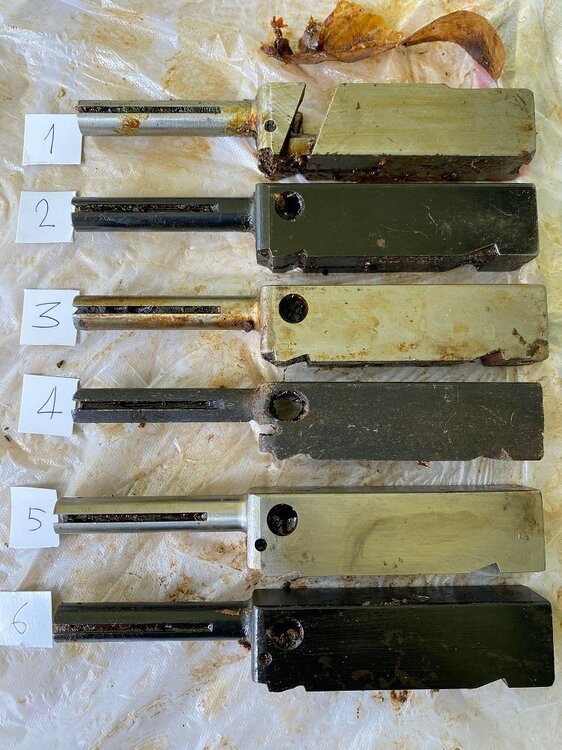

CadetMahoney Posted July 9, 2023 Report Share Posted July 9, 2023 Guys , bolt number 4 .. did it withstand 50 thousand shots , or is it an unknown author 's model from a secret studio ) ? Link to comment Share on other sites More sharing options...
