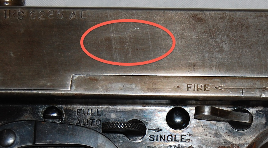

Robert Henley Posted June 9, 2012 Report Share Posted June 9, 2012 I was looking at a close up of picture 17, and noticed no SN. You can see upper left from where the SN would be what appears to be "IRS6225AL." The first three letters are hard to make out, so may be something else. I'm looking at ATII at the Colt section, and it looks like a non-Colt lower and the non-knurlled 1928 style actuator. I'd be interested in opinions on Colt parts and what you can tell from the pictures as well as the SN issue and anything else of interest. Thanks, Robert Link to comment Share on other sites More sharing options...

Robert Henley Posted June 9, 2012 Report Share Posted June 9, 2012 How would the SN be removed (without it looking like it's been removed in the picture)? Or can someone else see signs of the SN having been removed and I just can't tell because of the condition of the receiver. Link to comment Share on other sites More sharing options...
Sig Posted June 9, 2012 Report Share Posted June 9, 2012 How would the SN be removed (without it looking like it's been removed in the picture)? Or can someone else see signs of the SN having been removed and I just can't tell because of the condition of the receiver. I looked at it and it is hard to see. There is an option to blow up the picture 3X. My thought is that it looks as if the original number was ground off. It would be sweet to pull the barrel and get the hidden number, to trace that. Not sure about the non-Colt lower, agree on the actuator it looks to be two piece and clearly missing the knob, the safety lever is not original. Anyone else on the barrel, it looks way too shiny to be original to this Thompson but the pics and angles do not allow a strong opinion. Link to comment Share on other sites More sharing options...
mnshooter Posted June 9, 2012 Report Share Posted June 9, 2012 Looks like an overstamp "8" right where it should be.Definitely looks like weight rivets in the actuator.Anyone have enough influence with Franks to get him to pull the barrel?'Course, there's always the risk of damaging the finish. Link to comment Share on other sites More sharing options...
gijive Posted June 9, 2012 Report Share Posted June 9, 2012 (edited) Looks like an overstamp "8" right where it should be.Definitely looks like weight rivets in the actuator.Anyone have enough influence with Franks to get him to pull the barrel?'Course, there's always the risk of damaging the finish. I agree with mnshooter, there is a trace of something right where the Model No. and serial number should be. It appears that the serial number may have been polished off somehow, as that area of the receiver has some tool marks and striations present and no bluing left. It would be interesting to have the barrel removed and see what the real number is, if it is still there. Although, even if the real number was located it would be only of historical interest, once BATF registered the gun with the number they stamped on it, that becomes the guns serial number in BATF records. The grip frame is a Colt made frame. The internal trigger parts are nickel colored, as they should be and the rear grip is a Colt era grip, not a WWII grip. The only piece obviously replaced is the safety selector, which is a WWII replacement part. Barrel looks original, too. Of course, a closer inspection would be warrented to verify that. The actuator is a two-piece with an ear replaced, obviously. If thge gun is all original parts, it would be a scarce variation of a 1928 Navy Model (possibly) without a compensator. Of course, this is mere speculation on my part, the gun would have to be examined in person to be sure. Here are a couple of enlargements of the mark mnshooter is referring to: http://i414.photobucket.com/albums/pp227/Colt1928/Thompson%20Pilots/Mark1.jpg http://i414.photobucket.com/albums/pp227/Colt1928/Thompson%20Pilots/Mark.jpg Edited June 9, 2012 by gijive 1 Link to comment Share on other sites More sharing options...

Sig Posted June 9, 2012 Report Share Posted June 9, 2012 Nice observationsI thought that was an E and it did not make sense to me at the time so I ignored it.D'oh! Link to comment Share on other sites More sharing options...

Sig Posted June 10, 2012 Report Share Posted June 10, 2012 http://i414.photobucket.com/albums/pp227/Colt1928/Thompson%20Pilots/Mark1.jpg Dragged out some pics of my own collection and even opened the safe to make a direct observation.There should be no "E" for MODEL or even an "8" vertically where we see one here. They should be much further to the left or toward the barrel. Same goes for serial NO of course. In the top photo one can see a fairly deep gouge in the metal, where the MODEL and NO's are normally. Look below the tail of the arrow that Arthur put in his post. http://i17.photobucket.com/albums/b56/Polythemus/ColtTSMGnoserialcuedited.png Link to comment Share on other sites More sharing options...
Sig Posted June 10, 2012 Report Share Posted June 10, 2012 Here is the gouged area that I see. Link to comment Share on other sites More sharing options...

gijive Posted June 10, 2012 Report Share Posted June 10, 2012 Sig, Yes, you are correct, the numbers should be farther left. I did notice the shallow depression after you pointed it out. Maybe the finish loss is from the acid used to try and raise the serial number? Similar to the SVDM gun? Anyway, it would be interesting to know the real number of this gun. Maybe the new owner reads this forum and will be willing to let someone remove the barrel and see what the correct number is. Maybe it is the missing McSwiggin gun from 1926? Link to comment Share on other sites More sharing options...
