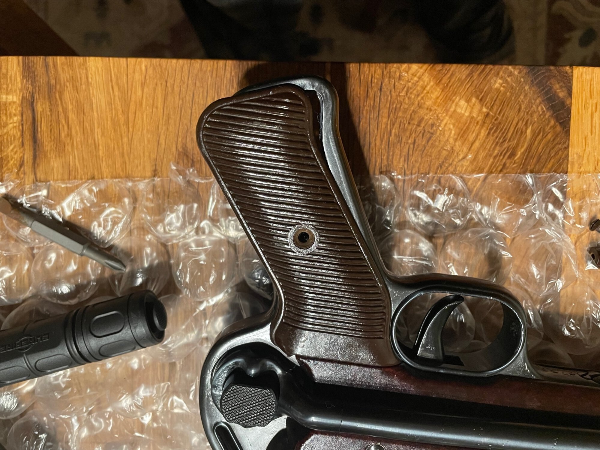

brodie74 Posted October 29, 2023 Report Share Posted October 29, 2023 Hello, first post and hopefully the topic is OK. I bought a Wilson MP40 tube gun on what looks like a pretty good parts kit. However, the grips I have with the firearm dont seem to fit. They look like they should belong but they seem way off. The story is a little strange - I bought the firearm online from a reputable dealer. The pictures I saw all looked great including the attached grips. So the firearm transfers to my dealer (who I have used a good amount) - I go take a look and get the paperwork started and the grips had been removed and were next to it. Seemed a little weird - they said the firearm came that way so whatever - looked like everything was there and everything was good - didnt think that much of it at the time. So eventually firearms comes home and I have a moment to sit and put the grips on and they just dont fit. Or at least I cant get them to fit properly. I attached a few pictures (hopefully they are discernible). If I align them to what looks correct you can see it sits way too far back on the frame - pic Grip 1. And if I align it so the top and bottom indents align with the grip frame the front of the grip is in the trigger house and the front edge hangs over about 1/8" over the front of the grip frame - pic Grip 2. And the third is just the grips next to the frame. But long story short I was hoping someone might be able to tell me if Im doing a bonehead thing attaching them, or they are actually grips for a different type of firearm, or there is something wrong with my grip frame and Im going to need a gunsmith. Hopefully, its just a matter of needing a replacement pair of MP40 grips but I wanted to reach out before I buy anything else. Thanks Paul Link to comment Share on other sites More sharing options...

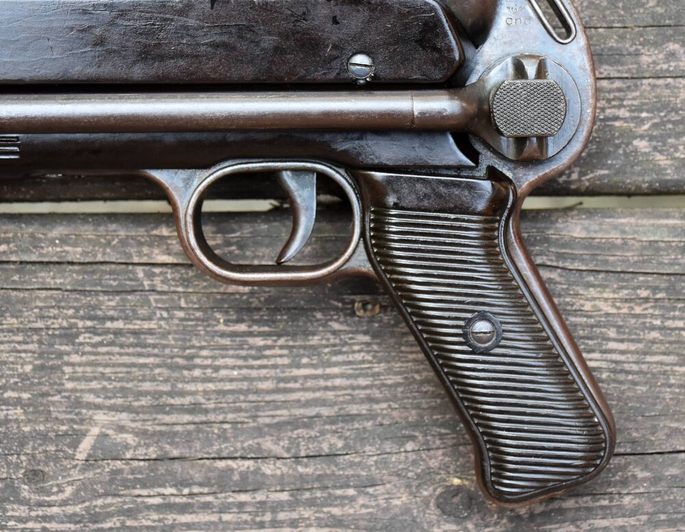

TSMGguy Posted November 2, 2023 Report Share Posted November 2, 2023 (edited) Pictured are original WWII gbm MP40 grips in pretty good condition. MP38 grips have a distinctively different shape. Looks to me like the gun got dropped at some point, bending the grip frame. If the gun was intact in the selling dealer's photos, then probably the damage happened at your transferring dealer, or enroute. I think that if the damage had occurred during shipping that one or both of the grips would be broken or shattered. Bakelite is a phenolic plastic that has excellent properties of chemical and heat resistance, but it's famously brittle. In other words, the frame was probably bent when the gun was dropped while the grips were removed. The frame will need to be straightened by someone who knows his business. Edited November 2, 2023 by TSMGguy Link to comment Share on other sites More sharing options...
Rekraps Posted November 2, 2023 Report Share Posted November 2, 2023 1 hour ago, TSMGguy said: Pictured are original WWII gbm MP40 grips in pretty good condition. MP38 grips have a distinctively different shape. Looks to me like the gun got dropped at some point, bending the grip frame. If the gun was intact in the selling dealer's photos, then probably the damage happened at your transferring dealer, or enroute. I think that if the damage had occurred during shipping that one or both of the grips would be broken or shattered. Bakelite is a phenolic plastic that has excellent properties of chemical and heat resistance, but it's famously brittle. In other words, the frame was probably bent when the gun was dropped while the grips were removed. The frame will need to be straightened by someone who knows his business. Funny you say that, I was going to, in jest of course, recommend that the owner use a vice to bring the grip frame into order! Link to comment Share on other sites More sharing options...

Maxim Posted November 3, 2023 Report Share Posted November 3, 2023 Yes, there is a visible bulge near the top of the rear grip strap. Must have been dropped, as speculated. Link to comment Share on other sites More sharing options...
brodie74 Posted November 3, 2023 Author Report Share Posted November 3, 2023 Hey definetly a bulge on the back strap but is on both sides - looked so smooth I assumed it was how the gun was stamped. But have never seen an MP40 in person till this one. On that note is removing the grip pretty easy? As noted earlier I could remove and send with grips to knowledgeable smith for repairs. If anyone has recommendation. Thanks Link to comment Share on other sites More sharing options...

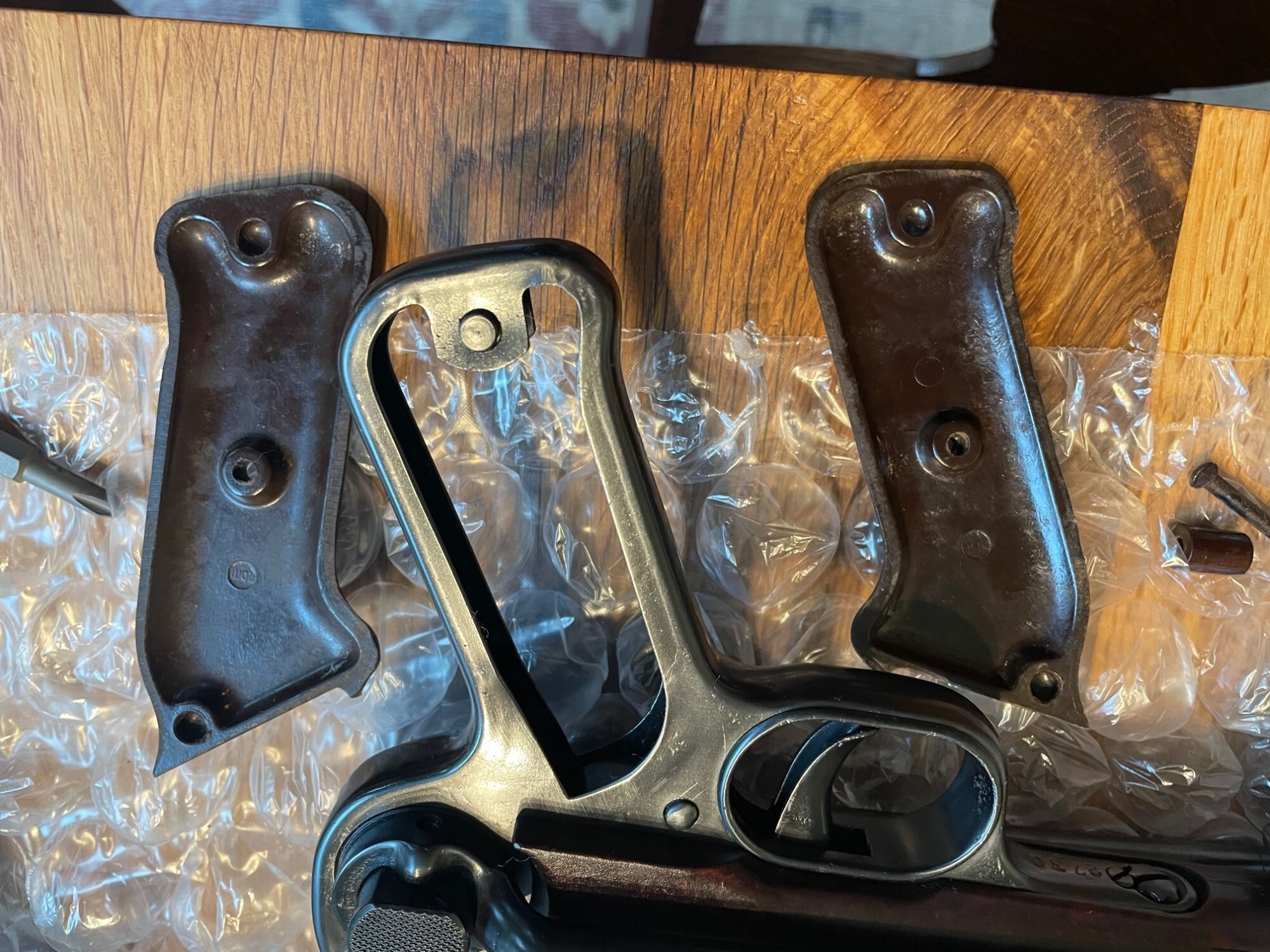

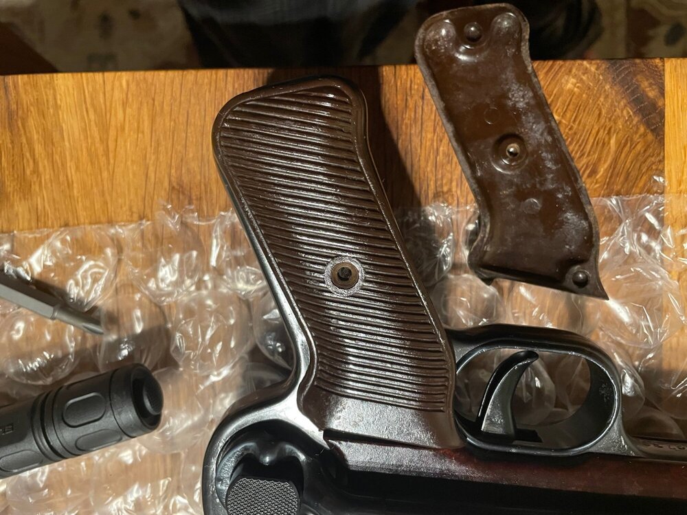

zavrit Posted November 10, 2023 Report Share Posted November 10, 2023 I purchased a parts kit several years ago and noticed the grip panels did not fit well. I took the grip panels off and noticed the deformed metal in the grip frame and this confirmed that the metal pistol grip frame was bent. I took it apart and bent the pistol grip back into shape and the grip panels fit perfectly. You can see the before and after pics. 3 Link to comment Share on other sites More sharing options...
Rekraps Posted November 10, 2023 Report Share Posted November 10, 2023 Wow, excellent work. How did you bend the metal back into place? Did it naturally want to go back to original shape? 1 Link to comment Share on other sites More sharing options...
zavrit Posted November 10, 2023 Report Share Posted November 10, 2023 4 hours ago, Rekraps said: Wow, excellent work. How did you bend the metal back into place? Did it naturally want to go back to original shape? Thanks. I removed the pistol grip frame from the lower and stripped it completely. I took an "L" shape custom punch that I made and removed the bent/deformed areas on both sides. Flattened about 50% of the way. Then *carefully* clamped the stripped lower in a padded table vice and hit with a plastic mallet. Hit a couple of times, then checked for movement using one of the grip panels. After it moved about half way, I took my "L" shape punch and flattened the bent metal so it is completely flat. Then put back in the padded vice and hit it a couple of times and checked with the panel. Kept doing this until the grip panels fit perfectly. It did not want to go back into shape and had to hit the pistol grip frame with quite a bit of force. The plastic mallet did not cause any cosmetic issues and it turned out great. 2 Link to comment Share on other sites More sharing options...
TSMGguy Posted November 11, 2023 Report Share Posted November 11, 2023 14 hours ago, zavrit said: Thanks. I removed the pistol grip frame from the lower and stripped it completely. I took an "L" shape custom punch that I made and removed the bent/deformed areas on both sides. Flattened about 50% of the way. Then *carefully* clamped the stripped lower in a padded table vice and hit with a plastic mallet. Hit a couple of times, then checked for movement using one of the grip panels. After it moved about half way, I took my "L" shape punch and flattened the bent metal so it is completely flat. Then put back in the padded vice and hit it a couple of times and checked with the panel. Kept doing this until the grip panels fit perfectly. It did not want to go back into shape and had to hit the pistol grip frame with quite a bit of force. The plastic mallet did not cause any cosmetic issues and it turned out great. The fortunate part of this is that one or both of the grip did not shatter when the grip frame got damaged. Bakelite is strong but notoriously brittle! Link to comment Share on other sites More sharing options...
