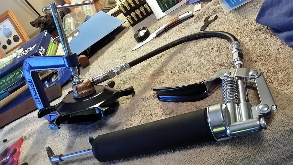

Stampcollector Posted July 11, 2017 Report Share Posted July 11, 2017 Well thought I would show my drum greasing set up, got all my drums greased now and filed and slicked up like I did the new "C" GPC drum that had trouble, even through the rest all functioned fine, Can't hurt to make them smoother!Have a nice day! Link to comment Share on other sites More sharing options...
