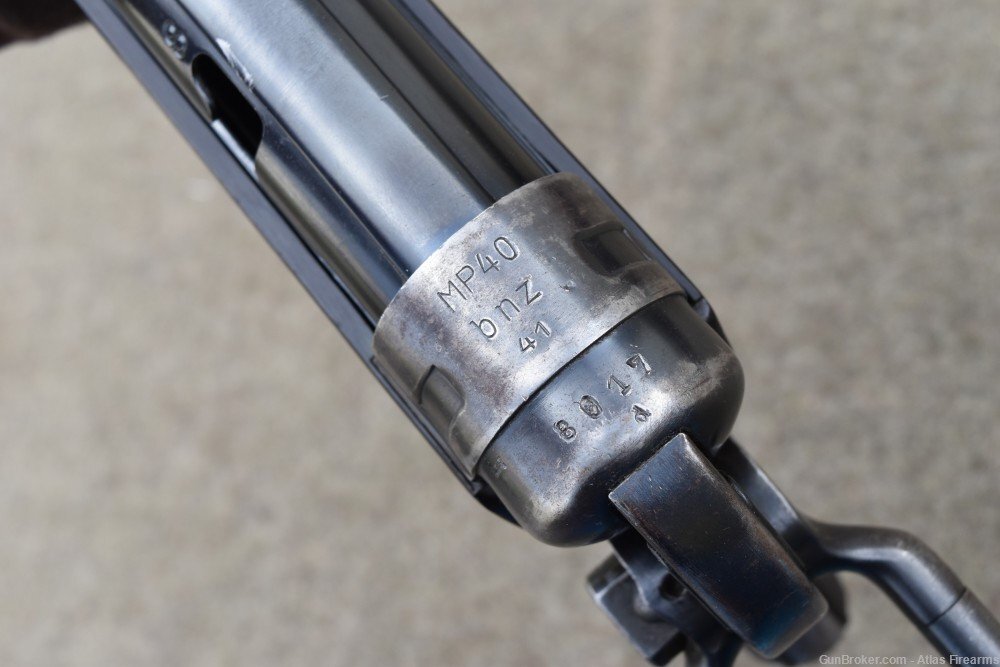

Robert Henley Posted January 8, 2024 Report Share Posted January 8, 2024 It will be interesting to see how this one does: Steyr MP-40 9mm Fully Transferable Machinegun WWII - '68 Amnesty Registered - Machine Guns at GunBroker.com : 1029755691 No resting bar and bolt appears to have two serial numbers stamped on it (in picture #57 8917 appears to have been added) among other issues. I'm not the seller nor do I know the seller. Robert Link to comment Share on other sites More sharing options...
Rekraps Posted January 8, 2024 Report Share Posted January 8, 2024 46 minutes ago, Robert Henley said: It will be interesting to see how this one does: Steyr MP-40 9mm Fully Transferable Machinegun WWII - '68 Amnesty Registered - Machine Guns at GunBroker.com : 1029755691 No resting bar and bolt appears to have two serial numbers stamped on it (in picture #57 8917 appears to have been added) among other issues. I'm not the seller nor do I know the seller. Robert So I own a bnz 41 all numbers matching and compared to this: It's a nice gun! I too doubt the originality of the bolt (big takeaway) but the rest of the gun seems good. What we don't see is the SN on the barrel thread protector, the front sight base and the folding stock release button. Also, the resting bars did have SN on them also, so another issue. IMO, excellent value at $25K, I suspect it will go low to mid-$30's (probably what it is worth). If the bolt were correct (I can only assume the rest matches) it'd be upper $30's. Link to comment Share on other sites More sharing options...
TSMGguy Posted January 8, 2024 Report Share Posted January 8, 2024 (edited) Looks mostly good to me. The broken or missing phenolic barrel resting bar is typical. On guns that have seen any original service, the finish on the top of the receiver is usually thin or gone above the take down knob at the natural gripping area. The receiver, barrel, and barrel nut all look buffed and lightly refinished. The numbering on the bolt looks period and correct for a replacement part. Not all items used in repairs were unnumbered prior to replacement. Edited January 8, 2024 by TSMGguy Link to comment Share on other sites More sharing options...

tommyboy Posted January 8, 2024 Report Share Posted January 8, 2024 For some reason it looks like the finish on the receiver tube, barrel and front sight don’t quite match that of the grip frame or stock assembly which show more wear. Almost like the receiver and barrel were reblued in the past. Link to comment Share on other sites More sharing options...
Robert Henley Posted January 8, 2024 Author Report Share Posted January 8, 2024 You can look at TSMGguy's and my BNZ41s for good comparison at the following thread: I see there is a bid now, so going to sell for at least $25K. Link to comment Share on other sites More sharing options...
Rekraps Posted January 9, 2024 Report Share Posted January 9, 2024 3 hours ago, tommyboy said: For some reason it looks like the finish on the receiver tube, barrel and front sight don’t quite match that of the grip frame or stock assembly which show more wear. Almost like the receiver and barrel were reblued in the past. Perhaps the gun was at some point in such poor condition that certain parts were conditioned to preserve it. Link to comment Share on other sites More sharing options...

TSMGguy Posted January 9, 2024 Report Share Posted January 9, 2024 (edited) 13 hours ago, Rekraps said: Perhaps the gun was at some point in such poor condition that certain parts were conditioned to preserve it. I think you're right. The barrel and receiver assembly, all of it, is much glossier than the rest of the gun. Looks like there was buffing. The original WWII finish, in good shape, would be duller and thinner at the gripping areas. Here are pics of the subject gun and mine. Note how on my gun the finish is equally thin from handling and use on both the receiver top and the end cap. Edited January 9, 2024 by TSMGguy Link to comment Share on other sites More sharing options...

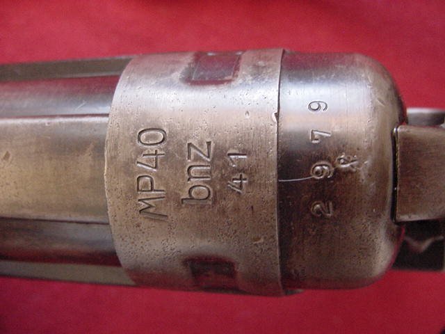

Rekraps Posted January 9, 2024 Report Share Posted January 9, 2024 6 hours ago, TSMGguy said: I think you're right. The barrel and receiver assembly, all of it, is much glossier than the rest of the gun. Looks like there was buffing. The original WWII finish, in good shape, would be duller and thinner at the gripping areas. Here are pics of the subject gun and mine. Note how on my gun the finish is equally thin from handling and use on both the receiver top and the end cap. What was interesting about my MP40 was not the field wear, but the "heavier" wear on the magazine well where the soldier obviously gripped the gun! You cold almost see the finger and palm marks where they wrapped around the mag well. Link to comment Share on other sites More sharing options...
